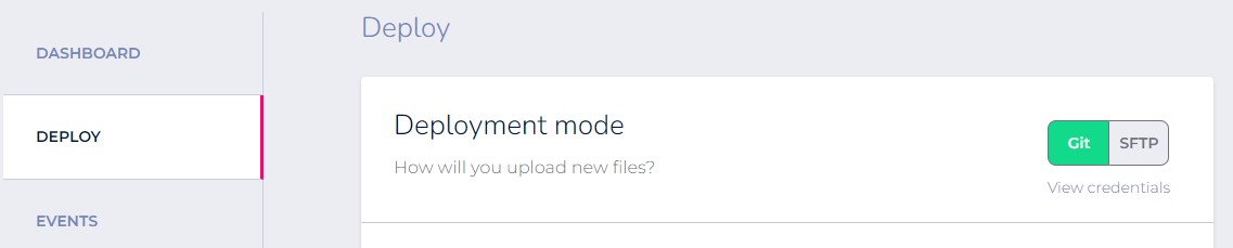

This feature is only available if you have set Git to deployment mode, DEPLOY tab.
The configuration is only accessible in the development environment, you cannot deploy to any other environment.

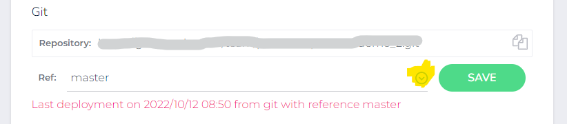

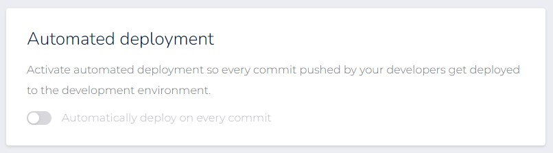

In the same tab, you can set the automatic deployment option. This gives you the ability to synchronize your development environment with the branch selected in the tab credentials. By default, it ismaster which is selected.
Every time you push something into your currently selected branch, a deployment is performed. This is also true if there is a merge request (MR) commit on the branch.
In the tab credentials, you will find a drop-down list with the list of branches available in the repository.
You can update it whenever you want.

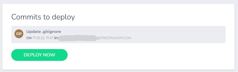

In the same tab (DEPLOY), new commits (never deployed) appear.
You need to press the DEPLOY NOW button to deploy the new commits pushed to the branch. This will deploy it into the environment. This is not necessary if you have enabled Automatic Deployment.

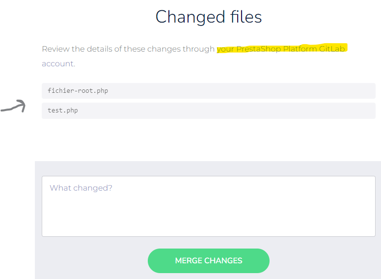

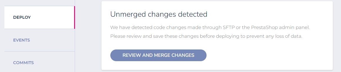

🚨 Be careful, sometimes updates were made directly on the server (via SFTP, a module, etc.). In the DEPLOY tab you will find a new window called "Unmerged changes detected" in which you will find the details of the updates (on a new branch hyperlane-my-branch ).
Two options, first, don't use it and clear the updates with a new (forced) deployment, second, click the "Review and merge" button to get the detail and use the GitLab link to go to the temporary branch created in order to compare with the latest version. You can easily merge and deploy.

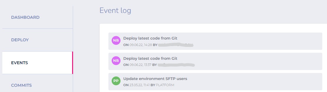

Now you need to check in the deployment in the EVENTS tab and a new line should be there with Deploy latest code from Git with the name of the user who deployed it and the date when it happened. For example :
A deployment may fail, you should be careful and use the documentation for debugging (see below).

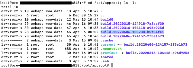

Clean your server of failed deployments
After a failed deployment, you may see build directories that are not used at all. We need to clean them up before the next clone, after a successful deployment. You can list these constructions here:
# Go to the approot directory or /vol/site
cd /opt/approot;
# List the builds
ls -la
The builds in use are those with a symbolic link to the current & previous directories. Two important rules you should keep in mind:
The current and previous directories should never be deleted! Never.
Do not delete build directories until the volumes have been unmounted. Never.
To unmount volumes, we will unmount and delete them one by one. Here's how to do it:
Select the one that is neither related to the current nor to the previous one, as in this example, the construction “build.20220406-105238-b5f54fe1”

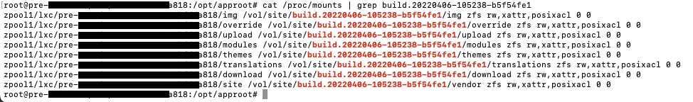

Now we need to unmount everything in "build.20220406-105238-b5f54fe1", we start by listing what is mounted:
cat /proc/mounts | grep [build_name]
You should get something like this:
We need to unmount each subdirectory listed, one by one, with this command:
