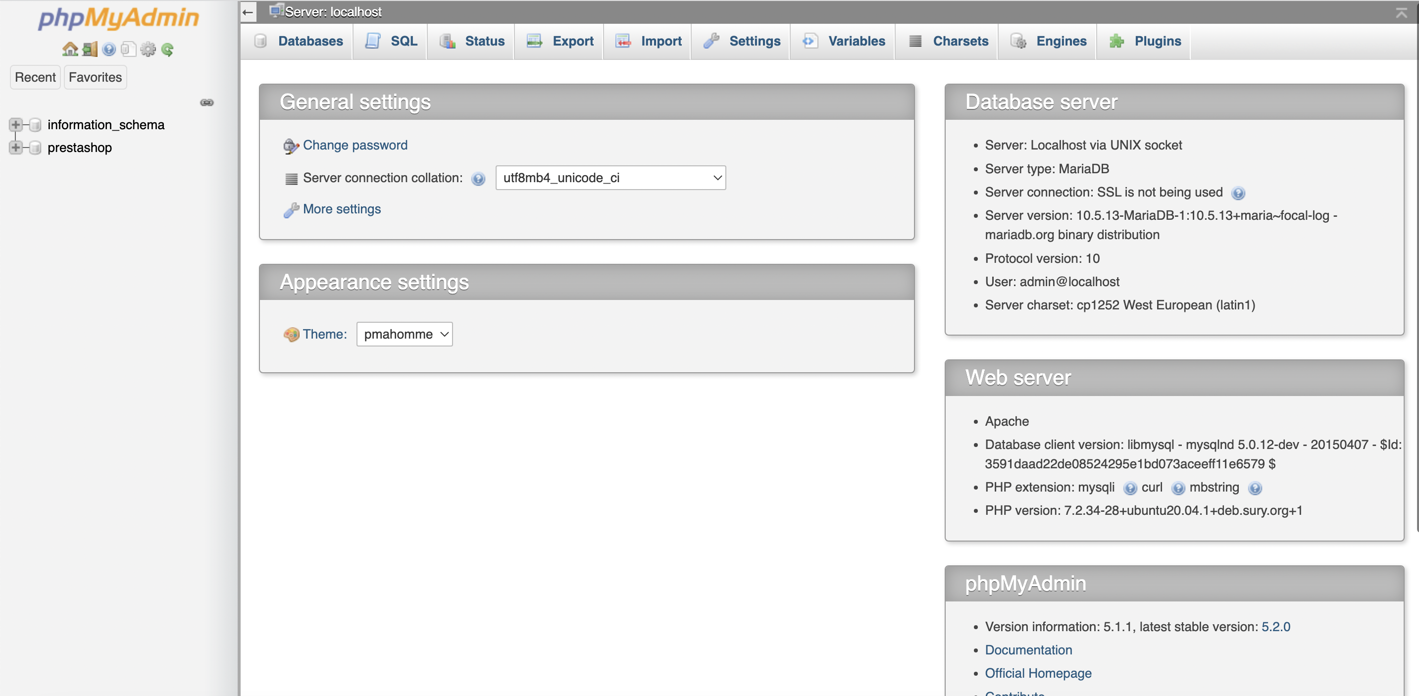

PhpMyAdmin

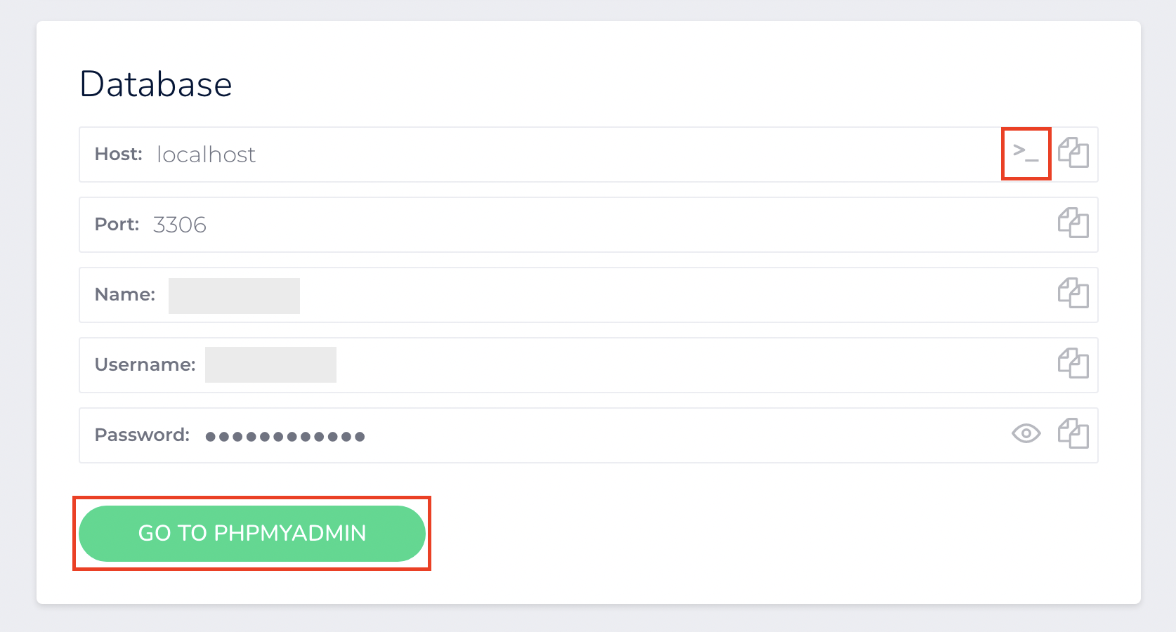

Logging in to PhpMyAdmin is very easy. On the Credentials page for each environment, scroll down to the Database section. There is a button that will take you directly to the PhpMyAdmin interface. Make sure to copy the username and password to the clipboard as you will be asked to enter these details.

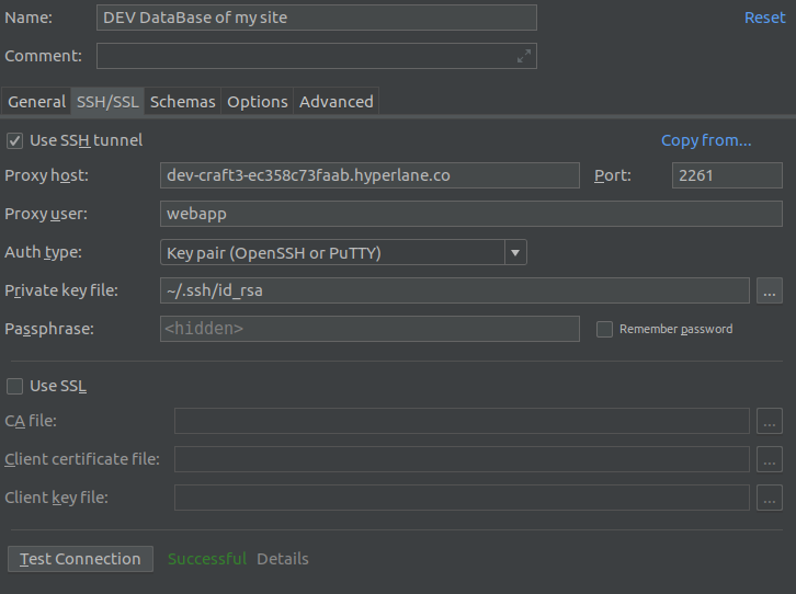

Database Explorer

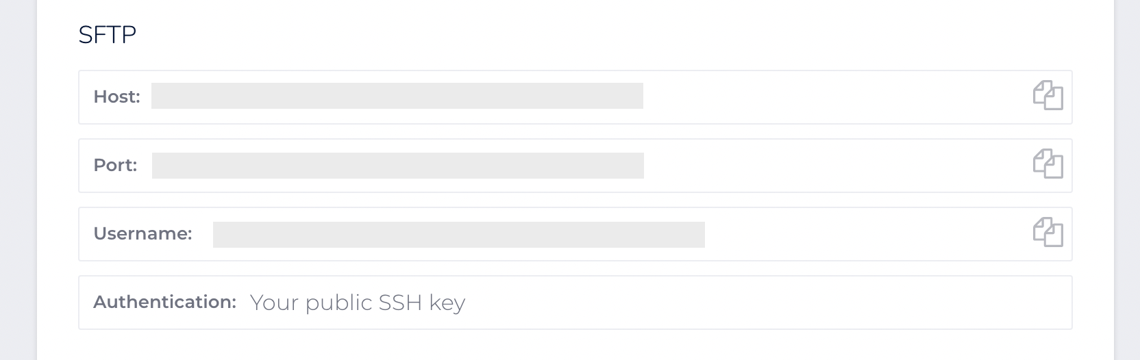

When adding a new data source in our tool, DataGrip, navigate to the second tab called SSH/Tunnel. The fields to enter here can be found in the Credentials tab under SFTP. There you will find the fields Host, Port et Username. Authentication will always be done with your private key.
Now that all settings are available, enter them into your data source configuration.

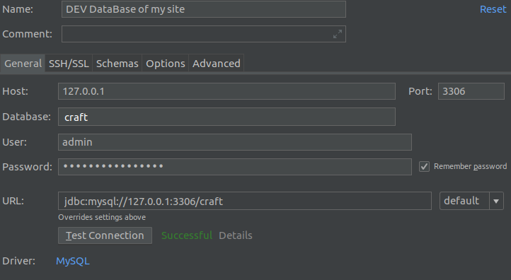

Database connection
Now that the tunnel is configured, connect to your database as you would a database on your local machine. Make sure to use 127.0.0.1 for your host and NOTlocalhost ! Port forwarding will not be available onlocalhost. The database username and password can be found under the section Database of your identifiers, just like those used for PhpMyAdmin.
When a tunnel has been established using the command line method, be sure to connect to the configured local port. (`13306`in this case)

First, you will need to navigate to the Credentials tab of PS Platform to obtain the necessary user and password.
